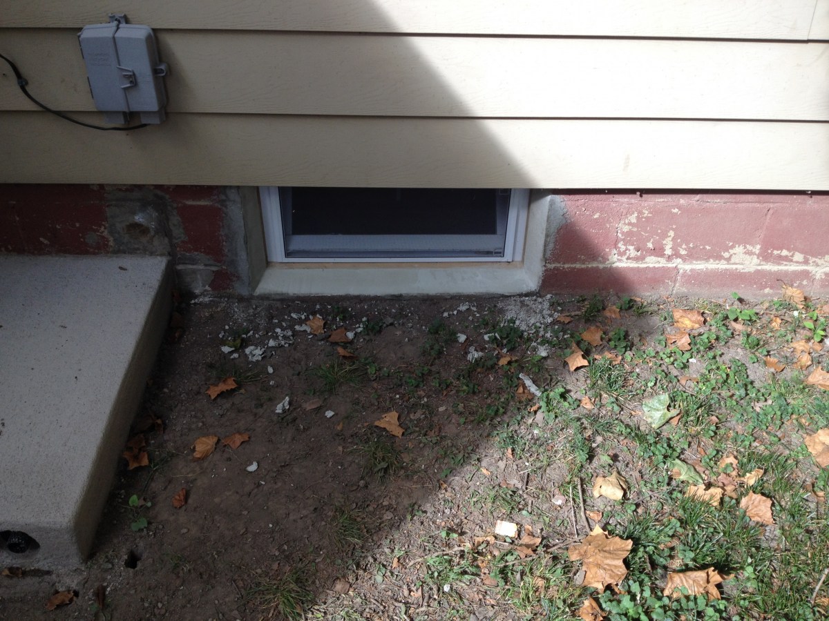

Since we are running out of warm and or dry weather, the rest of the day was spent on mudding in two basement windows, and looking for cracks in the block to fill in.
Doesn’t look like I will get to apply the gray primer this week (rain incoming). I am so tired of the ugly red paint the last owner chose for the foundation.

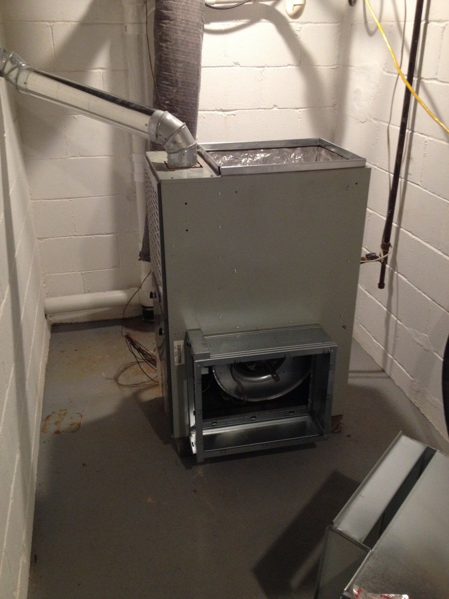

The backwater valve did it’s job, leaving me just with water intruding under pressure out of the block wall as high as three blocks off the floor, which is just over five feet below grade. Prior to the installation of the valve, I would have had up to six inches of water in the basement from the initial surge. At one point in the basement I could literally hear water running in the wall, and may have discovered another item I will have to open up and fix. It seems someone cut an old drain line that came in from outside about forty plus inches off the floor (you can see it in the picture of the furnace), and just covered it over with concrete. The drain was probably the one out of the garage floor and may also be from the storm tile off of the roof. Wherever it goes, or comes from, it still seems to be active and is running water into my block wall. You just can’t fix stupid… >:(
